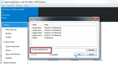

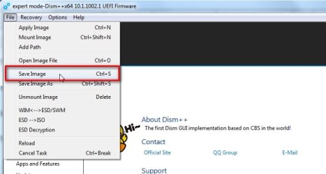

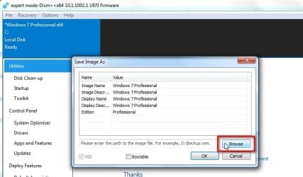

I am not familiar with shadow protect.
However there is a very simple way to make an additional backup image using microsoft own format of .wim
A small free portable program makes it easy. It is called Dism++ and is attached to the bottom of all my posts.
Just select the partition you want to capture in the top pane by highlighting it in blue ( if you only have one operating system it will already be highlighted ).
Click File >save Image
the details are already populated, you only need to browse to the location you want to store the wim file and give it a name
I have chosen to save it as R:\sources\Install.wim
You can update it later by doing the same again and pointing at the wim file you previously made. The changed files will be saved to the wim.
