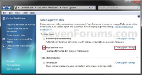

2. Open the Control Panel (icons view), and click on the Power Options icon.
3. Click on the Change plan settings link to the right of the power plan that you want to change the settings for. (See screenshot below)
NOTE: Normally you will be changing the power plan that you have selected as your default power plan.Step1.jpg

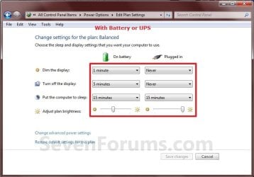

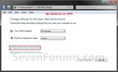

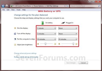

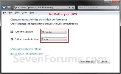

4. To Only Change the Basic Power Plan SettingsA) Choose how many minutes to wait for the Turn off display and Put the computer to sleep settings, or select never if you do not want to use a setting. (See screenshots below)
NOTE: If you have a computer with a battery (ex: notebook) or on a UPS, then you will see the right screenshot to adjust the options for when you are on battery or plugged in.Basic_Settings.jpg
B) When done, click on the Save changes button. (See screenshots above)
C) Close the Power Options window. (See screenshots below step 3)
D) You're done.

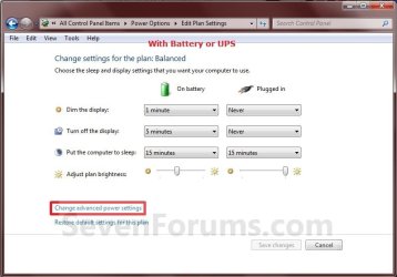

5. To Change the Advanced Power Plan SettingsA) Click on the Change advanced power settings link. (See screenshots below)Advanced_Settings.jpg
B) Click on the Change settings that are currently unavailable link. (See screenshot below)
NOTE: You will need to be logged in as an administrator account to be able to click on this option. This option allows you to change the power plan settings that are grayed out by default.Step3.jpg
C) Make changes to the power plan settings below to suite your needs. (See screenshots below)
NOTE: If you have a computer with a battery (ex: notebook) or on a UPS, then you will see the right screenshot to adjust the options for when you are on battery or plugged in. See the tables below for some recommended settings for Sleep, Hybrid Sleep, or Hibernate. The settings that are not included in these recommendations are settings that you can set to whatever you like. These are only recommendations, you can choose to do what you want instead of course. :)step4.jpg
