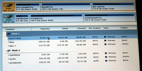

This is the partition info you asked for. If it is not clear enough, then I will have another try using different camera settings.
I am running the surface tests at the moment on both HDs - results later.

From what we can see the Win7 and XP (Acer) partitions are marked Active, but neither is also marked System (or Boot in Partition Wizard) signifying it is booting the Dual Boot system. So we have to assume you have no functional System partition.
To attempt to repair this, unplug the XP hard drive, boot into the Win7 installation media or System Repair Disk to run Startup Repair - Run 3 Separate Times until Win7 starts and wears the System Active flags in Disk Mgmt. The Win7 disk is provided in Step 6 of Troubleshooting Windows 7 Failure to Start .
Then power down to plug back in the XP drive making sure the Win7 drive remains set as Primary Hard Drive set first to boot in BIOS setup, boot again into Win7 partition to install EasyBCD (click Download - no Name or Email required), add XP on the Add New Entry tab:

If you incorrectly installed Win7 from XP and not by booting its installer, then it locked out the C drive letter for use so that Win7 will not boot as C as it always does when correctly installed from boot. You can keep it this way although most users don't want another drive letter and choose to Clean Reinstall Windows 7.
Startup Repairs will not be able to change the drive letter so that Win7 correctly boots as C if it does not already.
The Repairs are only to reestablish the boot files so that Win7 boots itself, then install EasyBCD to add XP to the Dual Boot.
You can first try running Startup Repair with both drives plugged in which can sometimes reestablish the Dual Boot. But if it won't then unplug the XP drive, confirm Win7 partition remains marked Active in Partition Wizard, highlight it's drive number, from the PW Disk tab select Rebuild MBR, OK, Apply. Since the Win7 partition likely never had its boot files to begin with (they were written to XP to establish the Dual Boot), it will then require running Startup Repair - Run 3 Separate Times until Win7 starts.
Once Win7 starts install EasyBCD to add XP. Make sure the Win7 drive remains the Primary HD set first to boot in BIOS setup when you plug back in the XP drive otherwise it will not boot.
Judging by the PW screenshot, XP also does not have its boot files intact so if adding it with EasyBCD doesn't give it the assist it needs to boot, you may need to unplug the Win7 drive to run Boot Repairs or an XP Repair Install. Then you can plug back in Win7, set it in BIOS setup as first HD to boot, select XP if needed to boot using the one-time BIOS Boot menu key. If this isn't to your liking install EasyBCD to Win7 to add XP.

Just to confirm, PW shows both drives there with both OS partitions as Active.

In PW rightclick XP partition to Modify>Set to Inactive, OK, Apply.
Then run Startup Repair again.
If Win7 is going to provide the Dual Boot for both then only its partition should be marked Active.
If this fails then unplug the XP drive and try again.
