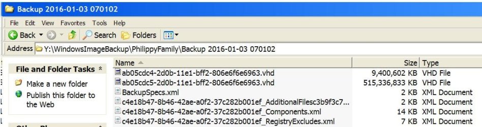

There's another issue that's been bothering me: I have two VHD files under the same WindowsImage folder:
Thoughts? I've been using the second, larger VHD to restore from, as it has both the recovery partition and the OS/data partition (there are only two).
