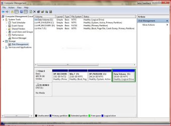

When I partitioned the 500gb drive to install Win7 I left quite a bit of space unallocated. I successfully booted between 7 and XP for a few weeks. Then, I assigned a drive letter (S: for storate) to the unallocated space using Win7 Disk Management utility. After doing so I was unable to boot back to XP.
This is what I have found so far:

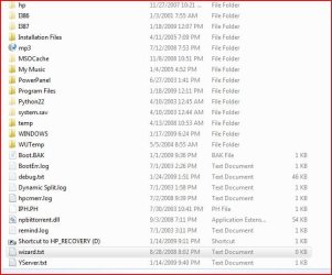

Reading several similar (but different) threads here and googling everything I could think of I thought my XP Boot.ini file may have been pointing to the wrong partition number and not booting properly. However, when I look under the C: partition through explorer there is no Boot.ini file at all.
I proceed to search the C: drive for said file and have come up with a couple interesting items. Boot.BAK does exist under the C: drive and Boot.ini.backup exists at C:\Windows\pss <-- (this "backup" is dated the same as my installation of Win7). These files both contain the same information.
I believe that XP is now on the 3rd partition when it was the 2nd one prior. Can someone please verify this from the pic below?

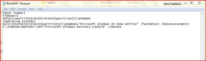

If XP is now the 3rd partition can I simply copy Boot.BAK, change it to Boot.ini and replace partition (2) with partition (3)??
What does the segment "/fastdetect /NoExecute=OptIn" mean/do?? I have a good idea, but really just wondering if it needs to be changed.

Thanks for the links SIW2. I did some more reading and decided just to update the boot.ini file and see what happened. Long story made short.... My C: drive (containing xp) was now the 3rd partition (previously 2nd). Correcting the boot.ini file allowed me to boot into xp.
Now I'm just waiting for Win7 to go retail so I can ditch the XP all together. Till then I am still sporting my dual boot with XP. My boot time on XP is about 1.5min till it is usable.... It's only about 45 sec on Win7. I'll give the "timed boot" option a try and see how close my estimate is.
So here's my final note on this issue: Using Win7 to create another partition on my drive modified the order in which the drives were reported and caused XP not to boot without a modification to the boot.ini file. Changed "Partition(2)" to "Partition(3)" solved the problem.

Well...... It turns out there was a boot.ini file on my C: drive after all. I was stumped by the absence of "ntldr" and "ntdetect.com" after reading the article you provided. I rechecked my folder settings and it turns out I had set to display "hidden" files but not "protected operating system files" . OOPS, rookie mistake.
Once I turned their display on I was able to modify the existing boot.ini file and reboot. I did not need any other changes.
I did confirm that boot.ini and boot.bak... and for that matter "C:\windows\pss\boot.ini.backup" all had the same information.
The partition location was the only value that I changed.
