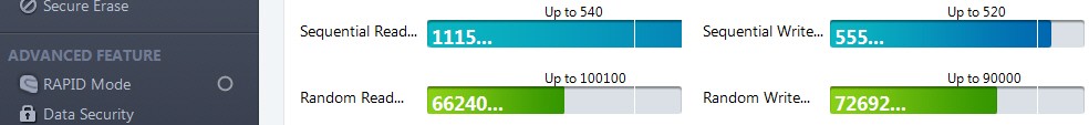

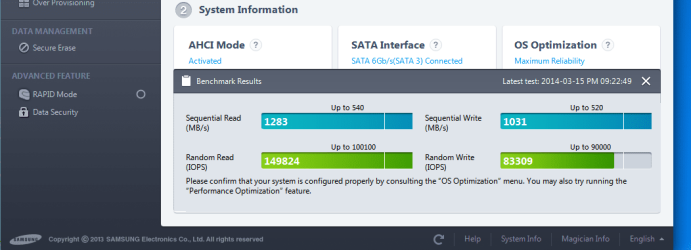

But according to the Magician performance benchmark test there is absolutely no doubt that there is VERY SIGNIFICANT performance improvement related to "rapid mode".
(1) here's performance with "rapid mode" DISABLED:
(2) and here's performance with "rapid mode" ENABLED:

Screen shot of speed with Rapid Mode on. 16Gb of RAM & running in Samsung's Reliability Mode

My 2 cents. There is no reason to have magician running at start up unless you have Rapid enabled. I am under the impression, and may be wrong, that with rapid mode activated magician needs to run at start up.
I have enabled Rapid mode, and like Gary said, it gives fantastic benchmarks but I saw no difference in day to day usage. Therefore, I disabled it and stopped magician from running at start up. I have too many thins that I do need to run as it is, and I call myself being very judicious about that.
Yes, I use overprovisioning. I have no shortage of space and feel that it could help longevity and perhaps the performance to be maintained. If I was running short of space, I would not enable it. Personally, I don't believe it is absolutely necessary, just one of those things you can do that may help a little but is not necessary. All SSDs that I know of, come with some over provisioning built into them in order to replace used or damaged nand cells and help maintain wear leveling. I feel sure there is enough built in to do what is necessary. But, if I can give up the space without causing myself any problem, why not. It may help but certainly won't hurt. But absolutely necessary, I doubt it seriously.
