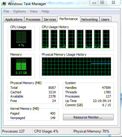

Here's a screenshot of the performance tab, if this is what you were asking for:

Nothing really unusual about the screenshot but with 127 processes it appears that there is a lot running.
There is nothing that would indicate a driver problem.

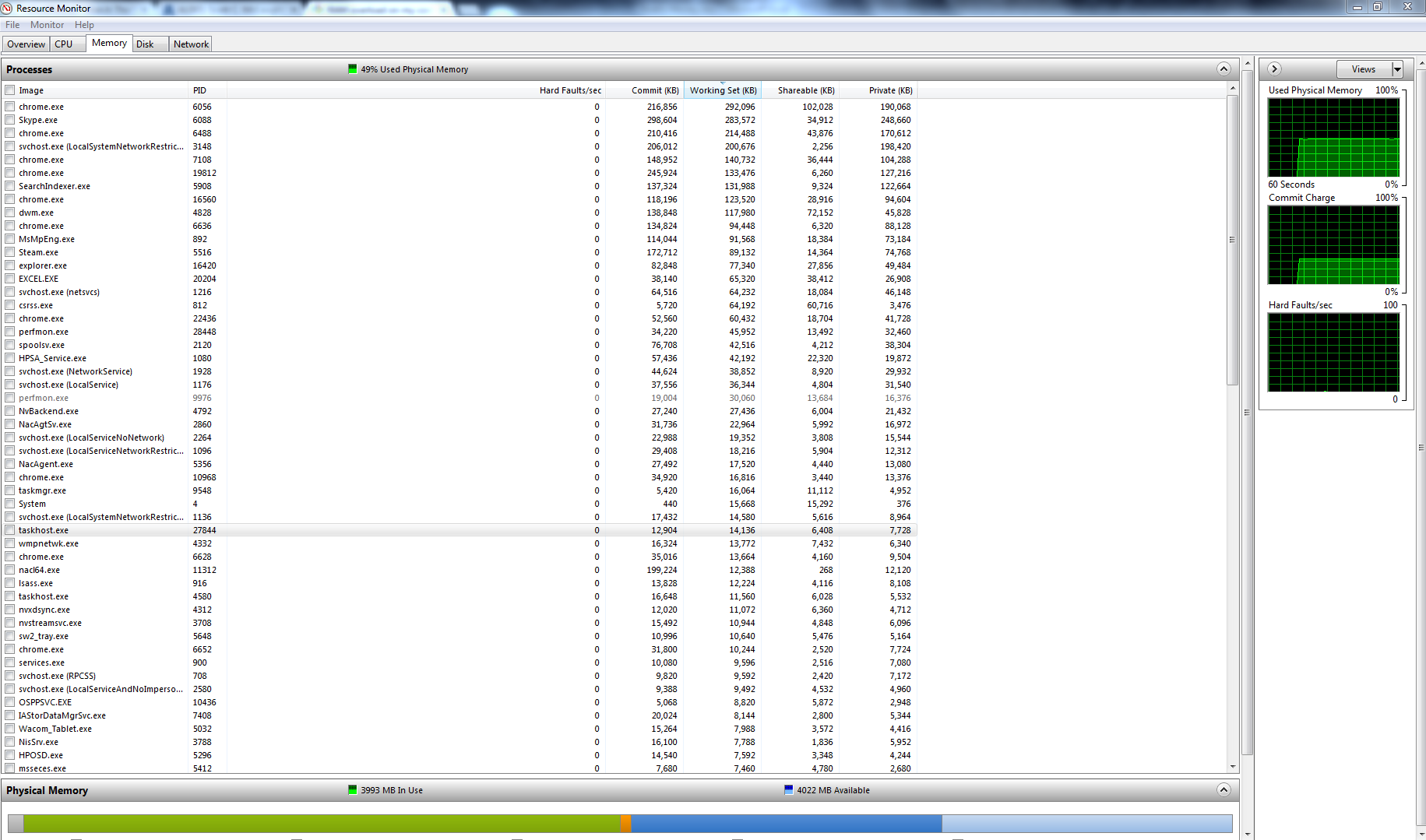

Post a screenshot of Resource Monitor - Memory tab, sorted by Working set. Do you possibly have a virtual machine (such as Virtual Box, or Virtual PC) running?

I'll get to work on that backup - here's a screenshot of the Resource Monitor.

I don't see anything that would indicate a problem. You just have a lot running. One big user of memory that neither Task Manager or Performance Monitor will show is the file cache. With a 32 bit OS this is severely constrained but on a 64 bit OS it can grow quite large. This is just for information. I am NOT suggesting this is a problem.

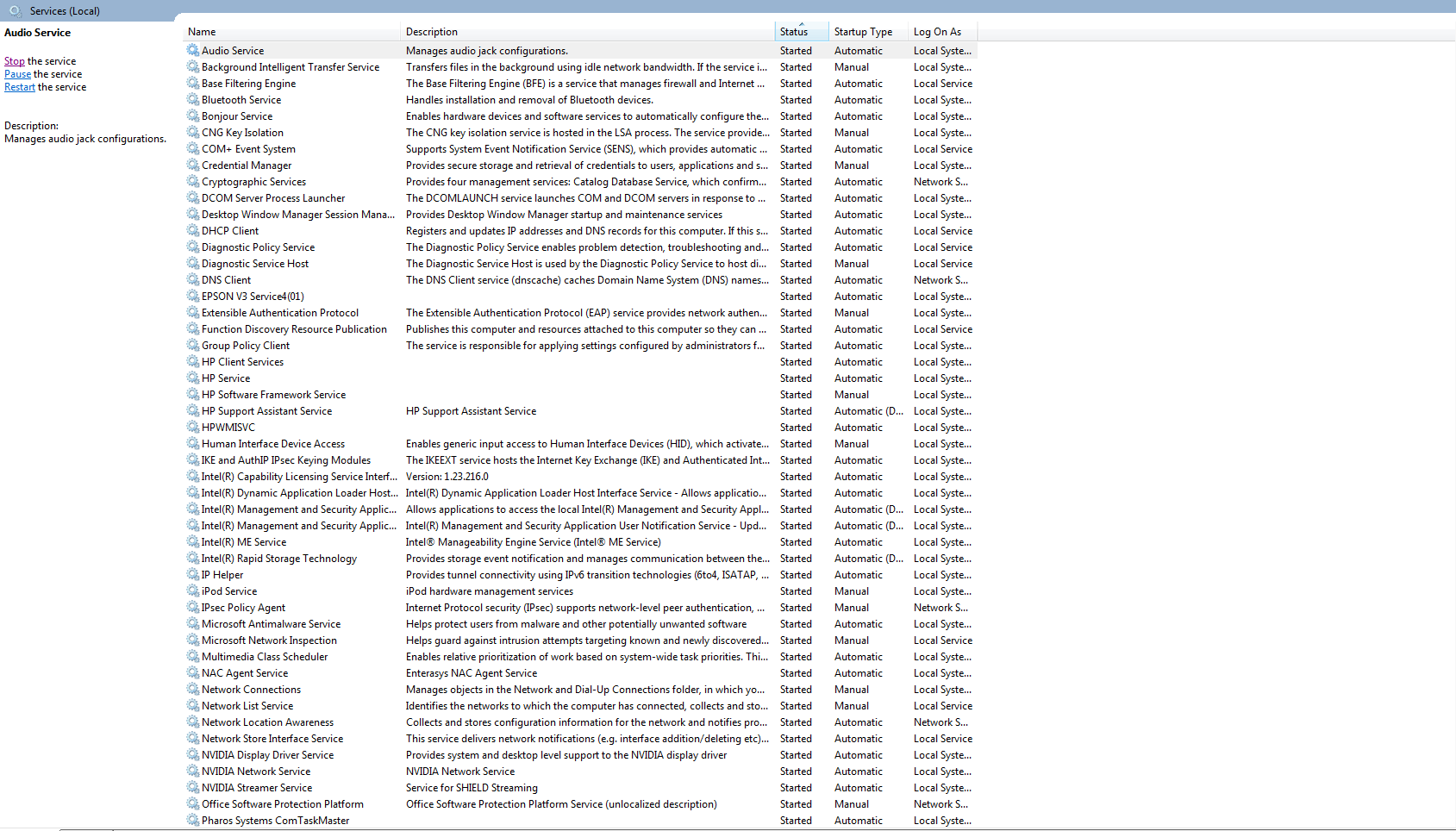

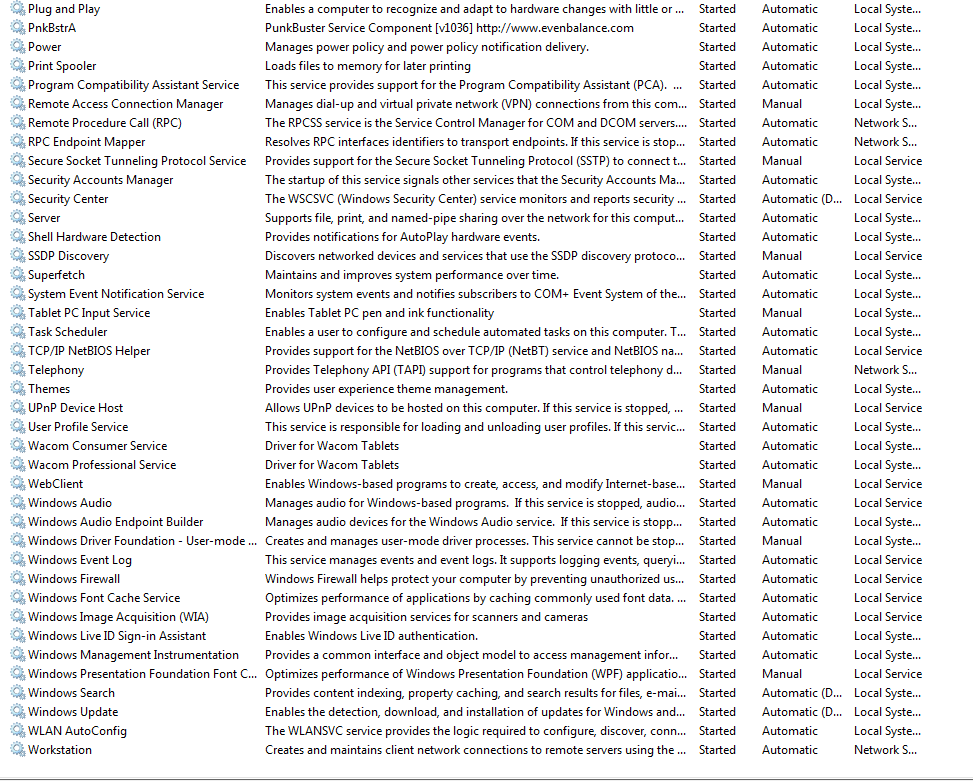

I'm looking through the services I have running on my computer and there are.. a lot, I think? Does this look like too many?
