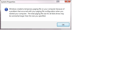

I'm having a problem with the error shown below reoccurring on random boots. I had the same type of errors showing up just before I put together my new rig, and since I did a clean install, I can't think of any hardware or software that would be common between them, that should have any relationship to the problem.
I thought that it might be due to the fact that my page file partition was set too small for the size set for the page files, but I increased that so that there should be about 2GBs of extra space.
When this error occurs, I check the page file partition and find no page file there, but I do find it back on C: at a size smaller than I set it. I'm quite puzzled about this, would anyone have an idea that would make sense of this?

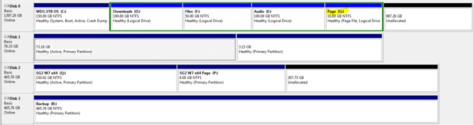

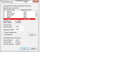

Interesting. Can you take a screenshot of your (working) pagefile settings from sysdm.cpl, and another screenshot of your disk configuration via diskmgmt.msc and post them here? I'd like to see what you're working with.
Here they are, for what they are worth:

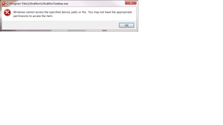

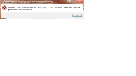

I'm not certain that it is caused by the same problem, but on random boots, I get a variety of error dialogs, some of which are shown below. When they do occur, it will usually take 5-6 minutes for the boot to finish and the system to become usable. The boot time is quick and normal until reaching desktop, it is from then on that the problem starts happening. Even after it finally finishes, probably only half of the programs that should be running in the System Tray are, yet UltraMon, which usually is included the the alerts does continue to operate as it should, even though sometimes it says that it run into a problem and has to exit. After a boot such as this, the next one may be perfectly normal, without a squawk. If this is the result of a faulty startup program installation, I would think that the problem would be consistent...it's not. Is there anything else that I can check?
