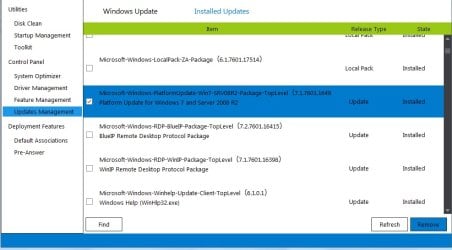

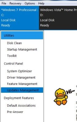

Run this on your other win 7 install, and select (highlight) the affected installation. then select "update management". click "installed updates. It will scan for a few seconds.
Tick what you want to remove.

It will automatically find all windows installations on your machine.
Highlight the sick install, select "open session", then select "update management".
Click "installed updates" and it will scan then list them. Tick the box next to the one you want to remove.

Have removed the update. Will try to boot to that drive now. Must sign off now and will report what I find.

Well, that didn't work. It removed the listing for that update in the list of installed updates, but it is still in the registry and all the packages are still in windows/servicing/packages

Yes, that is normal. The update has been uninstalled. Those entries and files should be removed at next boot.
Look at the most recent servicng\sessions xml file. The update is no longer active.
