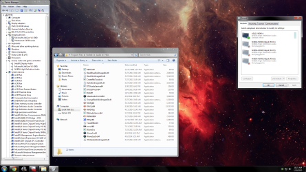

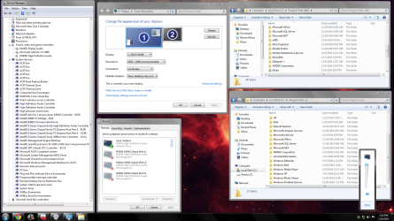

Thank you for the reply, I have attached screenshots of my device manager before and after uninstalling the Realtek driver. My computer is still using the monitor sound.

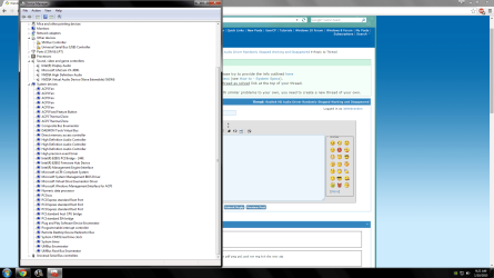

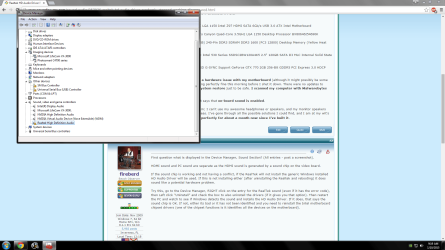

Here is another screenshot of my situation. As you can see Realtek is installed but is not detected by device manager nor does it launch through the .exe.
I tried using the Intel Driver Update Utility to automatically detect my drivers; however it only found an update for my on board graphics

If you are not using the Intel graphics, you can disable the Intel Audio.
I would also temporarily disable the Life Cam.
That gets you down to only the NVIDIA HDMI Audio.
Completely uninstall the RealTek drivers, if you can to get a clean start.
Also, if you installed the Gigabyte EasyTune software uninstall it. It will cause system problems, latency, pops and clicks. I had a Gigabyte Z77 board and it came with EasyTune6 and I was having dropouts and noise in my recording studio software, and it turned out EasyTune6 was causing the problems.
However, as the generic HIgh Definition Audio is not installing that says either a conflict somewhere or a hardware problem. I would like to think its a conflict, very rare do sound chips go bad (although they can).
Double check the BIOS to verify the on-board audio is enabled. Gigabyte web site is still down and I can't get info on this board.

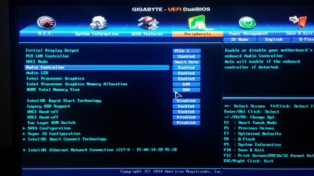

I have double-checked the BIOS and it says on-board audio is enabled. I have attached a picture of my BIOS for you to confirm. Also attached is a screenshot of my current situation with some relevant windows open. Sound is still only coming from the monitor after reboot.
How would I go about reinstalling the chipset driver? It's not something I've ever really tinkered with before.

Since the audio chip is not being detected, run the Intel INF chipset utility, Setupchipset.exe from Intel.
https://downloadcenter.intel.com/Detail_Desc.aspx?DwnldID=20775&lang=eng&ProdId=816
Restart the PC after the chipset install (reinstall). If its still not detected one last thing to try. Most Gigabyte motherboards have dual BIOS. Change to the second BIOS and see if that makes any difference. If not, it would appear that there is a hardware problem with the sound chip. Contact Gigabyte about warranty service.
