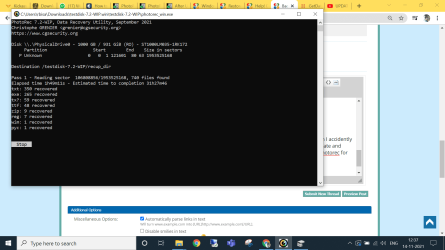

Now, I want to recover only the data part which should be around 50-60 GB from data partition (D:) which I accidently formatted. I have already tried minitool partition and minitool data recovery, however, both could not locate and recover data. Now I am trying photorec which is still running (found 740 files). Below is a screenshot of photorec for your reference:
However, I am looking for a software which could help recover original files with folder structure. Please help!

Just an update, I have stopped Photorec mid-way and started scanning using GetDataBack Pro trial version (Level 4) to see if it can recover files from data partition. Please find below screenshot:
Awaiting for @jumanji to take over and advise further action.

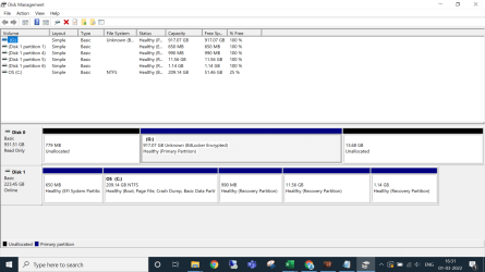

3. Currently, my disk management looks like below:
4. There were multiple partitions in Disk 0, before I ran diskpart clean command, since it had couple of in-build partitions received while purchasing the laptop.
5. I did not make any changes to the partition type originally received while purchasing the laptop, so no idea why was it logical partition.
I have tried several data recovery tools, none of them seem to work. I have lost all hopes of data recovery. Would appreciate any help.
PS: The 917 GB partition is Bitlocker encrypted, does that mean I need to decrypt the partition before running data recovery software. If yes, then, please provide steps for the same.
