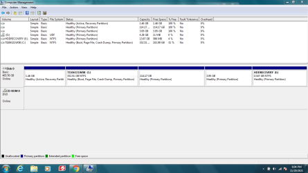

Did you created the Recovery DVDs?
The original boot loader was replaced by Linux Grub.
Let's see what you have on your drive
Please post a Disk Manager Image of your drive. Full window and expand the columns so we can read them.
Disk Management - Post a Screen Capture Image

HERE is the support site for the Toshiba Satellite C655-S5307 Notebook PC.
According to its marketing specs, it originally came with Windows 7 Home Premium SP1 64-bit.
If your listed specs are correct, it appears that its original HDD has been replaced with a SSD.
Does it still have a measly 4 GB of RAM?

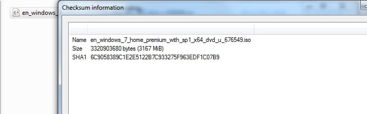

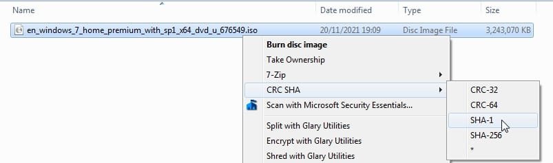

If you need the installation media, this is what you are looking for:
X17-58997.iso
OR
en_windows_7_home_premium_with_sp1_x64_dvd_u_676549.iso
the above two iso files are identical
SHA1= 6c9058389c1e2e5122b7c933275f963edf1c07b9

Often if the boot loader has been destroyed if you open a disk manage find the recovery parition and set it active reboot and it it should start
X17-58997.iso
OR

Use a hashtool to check the iso.
If you have 7zip, there is a hash option in that.
Disk Management - Post a Screen Capture Image[/QUOTE]

Megahertz07;I didn't understand if you reinstall (factory recover) or not.
If you did, you should update it with Single file with all updates - Simplix[/QUOTE]
I was finaly able to restore when the red warning screen came up and when I did a windows update it found about 50 updates (mostly security updates) and I did them all, I was surprised I could still do that. Thank again every one and again I'm sorry for the long confusing update. Mike
- - - Updated - - -
now I have to try that. Once I had win 7 up and running I thought I would try my official Toshiba recovery disk but it wn boot to them so I tried my 5 recovery disks I found and disk one seemed to be working but it errored out, might have said boot loader and now when I try to start up the computer it says no boot loaded found, any tips/suggestions. Thanks, Mike
oops, I meant bootmgr

If you set recovery as active and it didnt work you need to set 7 back as active parition
win 8 32 bit
win 8 32 bit
If you set recovery as active and it didn't work you need to set 7 back as active parition
When I hooked the hhd up to another computer via usb it shows very little on it so I think my only option is to get a new copy of Win7 from ebay or somewhere, Thanks everyone, Mike
