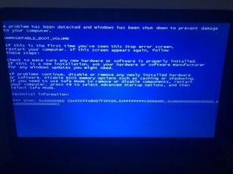

Hello, I need help, My laptop Dell with Windows 7 Ultimate 64x restarted and then did a disk check, after which it restarted again and gives me a blue screen, in the blue screen error appears UNMONTABLE_BOOT_VOLUME. I had a windows stick attached to the usb before this. I managed to check the memory and the hdd in Bios and there were no problems. I managed to enter with Linux Live and it found both partitions from the hdd. But I want to repair this windows because I have all the passwords saved there. I tried to repair it with a Windows 7 DVD, but it appears after I click repair, that blue picture and it stays like that, I can only move the mouse cursor. Thanks a lot

Welcome to the Forum.
A disk check started by windows means that something got corrupted. Your drive may be failing.
Boot from a Win 7 or Win 10 installation drive. At the Windows Setup screen, press Shift+F10 simultaneously to open a command line prompt. Type:
diskpart
list disk (see if there is a * on the GPT column)
list vol (take note of the Windows partition letter. It may not be C:)
exit (to exit diskpart)
chkdsk X: /f (replace x with the Windows partition letter found above)
Pay attention on the results, specially bad blocks, bad clusters, bad sectors etc

Hello @Megahertz07, I will try today that, those operations will not delete my files? I use some Windows PE via USB and my C partition is Raw. I put 2 pictures, maybe will help, one is when I boot from DVD windows, and try to repair, and other is about blue screen error number.

The instructions I gave you won't make any changes to the drive.
Can you post an image of Windows PE via USB that mention C partition is Raw?
Can you launch disk manager under the Windows PE? If you can, take a picture and post the image here.

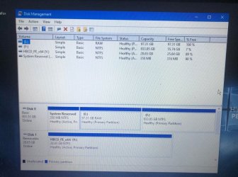

Hello, sure, sorry for late post, but I havent sleep and I was upset :( I put some pictures, what you ask and other with some error about recycle bin. Took to much time to boot from Windows PE and to enter in disk management, I use Windows PE from usb stick, not from a Dvd. E partition is my C with windows :( But in Linux Live, windows partition is there, I can acces files, isnt RAW like in Windows PE. I try to upload pictures, but I give me this error

I put picture with disk management here:

You have a severe HDD issue.
DON'T TRY TO FIX IT.
jumanji is the drive expert. Wait for his instructions.
Please edit your profile with ALL your hardware specs. It will help us to help you

Thank you, I check hdd life in hd tune, in Windows PE, is 100%. I just want to boot again in Windows to save my programs info, or to clone my C, to save my information and programs, somehow :( I am very sad :( Hope jumanji will help me, I waiting his help here. I dont know all my spects, but I will but what I remember. Thank you for your time and help

A drive can have a software failure or a hardware failure.
A hardware failure can't be fixed. The drive seems to be good, as other partitions are OK
A software failure can be fixed using the right tools.
Trying to fix can make it worst so wait for him. jumanji lives in India so it can be a big time difference. Where do you live?

It is showing Raw.
Looks like a case of data recovery.

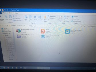

@Megahertz07, done, I set it, hope is good now, becase I didnt find my country to set it. And above I put picture with what software for partition I found.

Mini Tool partition 9.1 has a good recovery tool.
DiskDenius is a good tool.
Let us see what Jumanji ask for.
Don't worried, jumanji will help you to fix the drive.
