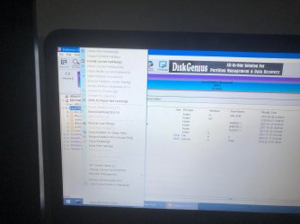

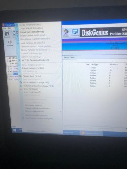

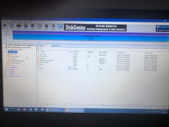

@SIW2, what Hiren do you have? Can you give me? Your program is a new version that I have. Because mine is loading very hard, I waiting for Diskgenius also few minutes :( This is what I got there, but no partition parameter option.

Rt click on the windows partition not on the disk

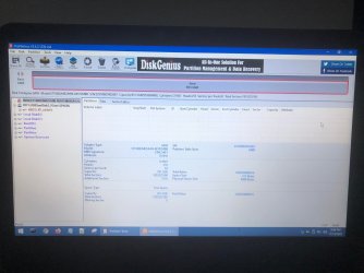

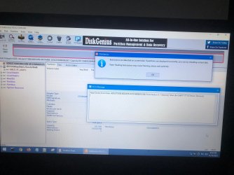

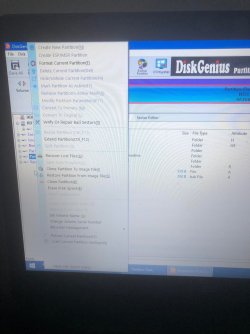

Here it is, from both partition.

Looks like diskgenius doesnt want to modify anything because it has detected bad sectors.
Have you made an image?
After that try coping out files/folders. If you cant see your files\folders the next thing is to try a data recovery program.

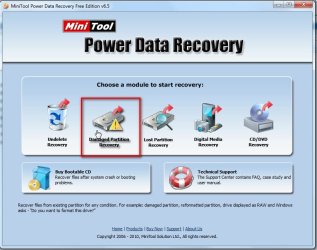

I would try this one:
Ther are different ones in hirens you can try.

Can you see your files and folders if you click the Files tab in disk genius ?
If you can see them they can be copied out by rt click any file/folder and select to copy it to your destination
If you cant see them, then you will need to try a data recovery program

I can see them, but not all, I dont know what else to do ... I havent sleep, just a bit. This is to much for me. And about my question?

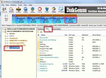

I think it is the same hiren that you have. I am posting my diskgenius screenhots from my current operating system, just to show you how it works.
It is probably taking a long time to load for you because of the sector damage.
