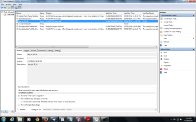

In general >> bkp_to_30_28
clicked on below radio button -
run whether user is logged on or not
do not store pasword.
run with highest privileges.

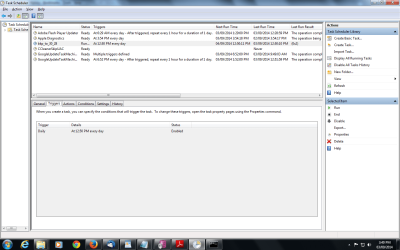

In Trigger >> Daily --timing --enabled

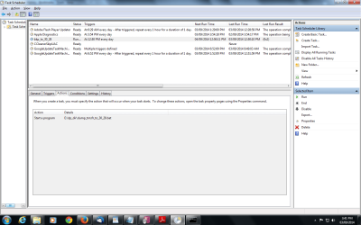

In Action >> path of the batch file.

Try changing the Security options to 'Run only when user is logged on' and un-check 'Run with highest privileges'
Now change the 'Configure for' drop down box to Windows 7
OK/Save that and see if it runs now?

Thanks a lot.
May I know what is the difference between the radio button? I was using always "Run with highest privileges"
After doing the changes, my folders is getting transfer to the destination server (manually started the task manager).

Have you tried placing the path in double quotes ? I know in theory you only need to do this if there is a space in the path / directory name, however task scheduler tends to treat batch files differently and in order to get mine working with it the path needed the double quotes added... worth a shot easy enough to change back if it don't work.
