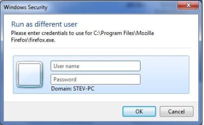

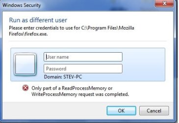

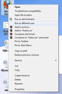

Please help, I got error after trying to run an exe as different user. It works perfectly on my windows XP but doesnt work after upgrade to windows 7!
Look at pictures attached, thanks
W7 Ultimate 32bit
Hello Stev, and welcome to Seven Forums.
Since this is on a domain, are you entering ComputerName/UserAccountName (ex: STEV-PC\Stev) in the user name field?
