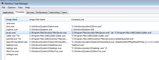

...I have to assume that unless a process is marked with *32, it must be 64bit. I didn't see any other way to verify....
That last quoted line may have led to your solution :-)
You are correct out the 32bit vs. nothing in task manager, but to show you how to see more info, I turned on more columns (and turned others off to make the info fit) then I took this screenshot:
The command line info within task manager led me to make a shortcut like this:
"C:\Program Files [B][COLOR=Red](x86)[/COLOR][/B]\Java\jre7\bin\javaw.exe" -jar "C:\Program Files (x86)\Jubler\Jubler.exe"
Create a shortcut like that to force the OS to start Jubler using the 32bit version of Java. Use that shortcut to start Jubler.
Let us (and Jubler's author) know if that solved it for you.

Please read thru the entire post (including the warning at the end) before you take any actions suggested by this post.
....I checked to see what would happen when I started Jubler with the desktop shortcut the program places and the behavior is the same as what I complained about even though the entry in task manager for Java appears to be the same as the code you provided....
Please check that again.
If you start Jubler using the shortcut that the Jubler installer creates...
...then there should be two Jubler related entries within Task Manager:
One for the Jubler process from the 32bit \Program File (x86)\ folder.
And another one for Javaw.exe from the 64bit \Programs Files\ folder.
Notice that the (x86) is missing from the folder name for the javaw process. Both Jubler related entries are shown in the screenshot in my earlier post. Look at that screenshot again and notice the row that is selected (highlighted in with a light blue line). All that I did was copy that whole command line and add the (x86) part to the path so that we could use the 32bit version of Javaw to run Jubler.
Normally, 32bit apps install into the program files folder with this name
Normally, 64bit apps install into the program files folder with this name
\Program File\
You should have these folders:
\Program File (x86)\Jubler
\Program File (x86)\Java
\Program File\Java

The Jubler process starts Java with these command line parts...
...path to 64bit javaw.exe
...a java switch (-jar)
...path to Jubler
...path to the file that you clicked on
Then Java works its magic and a Jubler window appears.
(But Jubler is somewhat broken because of the 64bit Java.)
So - why did I bore you with all of that?
Because the work around that I posted earlier jumps in the middle of the process. It does not fix the whole process. Let me try to explain that by summarizing my ramblings above with the 5 steps below.
