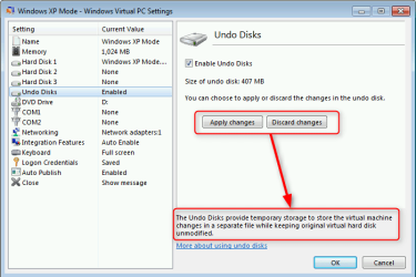

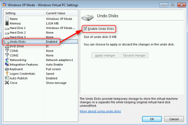

  • Use Virtual PC's Undo Disk feature. It allows you to discard all changes whenever you feel unsecure or have reason to believe something unwanted has happened. All virtualization programs have a similar feature, for instance in Hyper-V it's called Checkpoints and in VirtualBox Snapshots
    • Enable Undo Disk:
    • After shutting down, you can discard your changes:
  • Keep your own XP Mode files and documents stored on an external device (important especially when Undo Disk feature is used for not to lose your files)

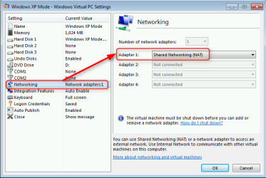

  • Use Shared Networking. It puts XP Mode in its own 192.168.131.X subnet and does not let possible malware infections through to your host system:

Using NAT (Shared Networking) on Virtual PC gives every vm the same IP, 192.168.131.65 with default gateway 192.168.131.254. This puts the Virtual PC vm's in a different subnet than the host machine, very effectively protecting the host and other networked devices from threats coming from virtual machine.
Only negative side effect of this is that different subnets makes communications with other networked devices harder, for instance a network printer cannot be installed on XP Mode when it's using Shared Networking. Trying it will only produce an error message about different subnets, to get it working you have to change Shared Networking to bridged mode. Personally I recommend keeping Shared Networking enabled, not to install network printer but instead move documents needing to be printed from XP Mode to host and printing from there.
