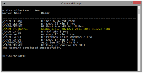

English for other geeks to understand: Please give me the exact NET VIEW error message, original in German. Or even better, take a screenshot of command prompt window with command output and post it here.
If network discovery is on and samba correctly configured, it should be shown in NET VIEW as for example in this screenshot from my home network:

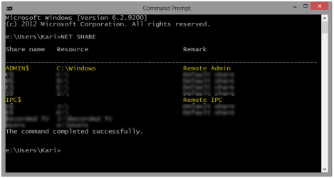

In the mean time please check with NET SHARE command if you can see the ADMIN$ and IPC$ shares?

i can confirm positively that i can see with net share admin$ and ipc$. i can see other windows machines with my notebook. however i have another windows machine that can only see the debian server after the first connection to the share. beforehand that machine can not see the share under the network environment. i think i described the behaviour in my first post. it is quite weired. One windows 7 machine can see it and access it perfectly!
