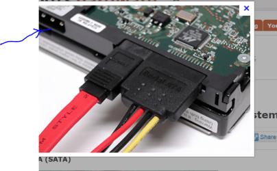

Hi there
sounds like you have a similar disk that I had and am using now as an internal HDD.
Get the base disk off the container -- just pull off any attached connectors --get the barebones disk drive out of the enclosure
Those Barracudas are 7200 RPM drives and are decent performers so it's worth saving however you look at it. 750 GB is a decent size too.
The metal plate probably just holds the DISK into the container -- don't pull off the metal disk CASE however.
it should look something like this - screenshot enc.
It's possible also on the older types power is supplied (for an external drive) by the 4 pin connector where I've marked it in blue as these were done so older Power units could be used with modern mobos to supply power for SATA drives using the older 4 pin IDE power cables.
You don't need to use that any more as the two sata connectors or on the right (DATA and power) will supply the power and correctly connect the drive to the MOBO.
If you don't have enough SATA power connectors from your power unit just plug the SATA data connector to the MOBO and use one of the 4 pin IDE power connectors where I've got the blue arrow --or use an IDE to SATA IDE power cable adapter like I've shown in a previous post in the thread.
Don't throw the HDD away - it's definitely useful and useable.
(With the money you save by not buying another disk to replace this one you could even get an SSD !!!).
Cheers
jimbo
