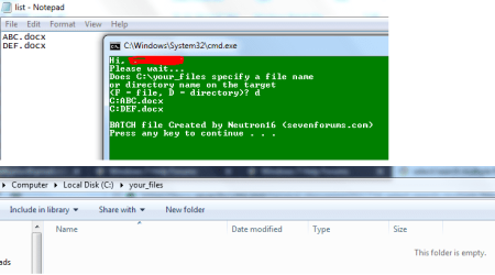

That is an easy task for a batch file, if your list of 1000 files names can be saved in a txt file with every file name on separate line. Something like this:
Report_23.docx
Presentation45.ppt
Diagram_67.xls
Then save this list to txt file; rename it to list.txt and put in your folder of 5000 files.
Download and extract a script in attachment. Start that script "ZZZZ_script.bat" AS ADMINISTRATOR , in the same folder of 5000 files. It will open your list.txt file(which should be there already) and will start searching for files and making copies to C:\your_files folder, which is predefined in that script.

Hi everyone, for all those who struggled to get it working. I did too.
Don't make any of the below mistakes as i finally got it to work.
1. Save your file as text file and when you name it - do not name it list.txt because the file is already a txt file and it will add the .txt automatically. So name your file simply 'list'.
2. I placed my folder with my files in C drive.
3. Make sure your file name in the list file have the correct title e.g. even if the file name is 12345, if it is a jpg file, it's name really is 12345.jpg - get this part right!
4. Create a folder and name it your_file and place it in C drive.
5. Finally - Neutron 16 had two attachments, only one worked for me, so try both!
