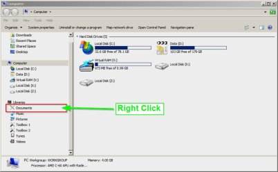

More thoughts
Perhaps if you always leave the external drive switched on when the computer is in use you might not see the fault appear. You can test this theory anyway!
On another note also try checking the following:
Open an Explorer window and in the left pane expand "Libraries" then right click on your Documents Library and click "Properties" - it should point to "My Documents" like this:
In the screenshot where is says "Chris" you should see your user name in it's place. If that's not the case or more than one location is shown post a screenshot if you can.
Are you the sole user of this machine? If not - try logging into another user's account to see if the same problem occurs.

I can't actually see Chris on that pic!
However, when I rightclick on do****s, then properties, I get C:\Users\Mike.

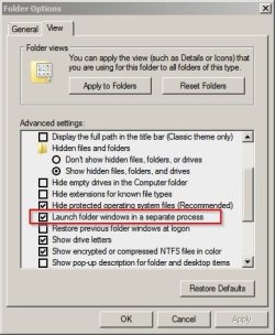

One more suggestiion
I don't think that this could be a problem but try checking/ unchecking the checkbox shown in the screenshot below. Just reverse your current settings - check the box if currently unchecked or uncheck it if currently checked. Then test for a while after a reboot.
Start> Computer> Organize> Folder Options> View
