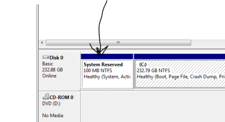

"Error: 0x800f0a12" right at the start of the installation. :/

disk management
Hi Zarkith,
Please navigate to Disk Management
(Controlpanael>> Admintools>> Computermanagement >> Disk Management)
You need the arrowed 100Mb system reserved, and it must be active ??

My system reserved partition wasn't marked as active, but it otherwise seems fine.
Changed it to active, ran the SURT again, here's the log:
