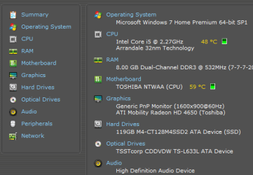

My Toshiba readout is as per pic.
Let us know how you go:)
