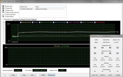

I don't know if this is applicable, or helpful....but here ya go. Shown here is a snippet of AIDA64 and RealTemp running a stress test for about 30-40 minutes. After roughly 5-10 minutes, my CPU Cores are just about as hot as they will ever get. That is how long it takes to register the shock of 100% load. Notice the temps it is monitoring: Motherboard, CPU, Core 1-4, and CPU Package. CPU and CPU Package will sometimes have a value all their own(even though CPU Package in this snippet looks to be similar to the core temp). I don't really know what the CPU temp is measuring, and from what I have read, CPU Package may indicate the temperature of the socket.
I know this is an Intel, and likely may have no relevance to this thread, but it is showing that there is a big difference between CPU and Core, and sometimes CPU package temps. Also, all of these programs that measure temps, may be measuring something other than CPU Core temps. Just a thought.

CPU package temps are ridiculous when I test and look at HWmonitor, listing my package temp at 105 celcius.
First time I saw though.. I went crazy.
