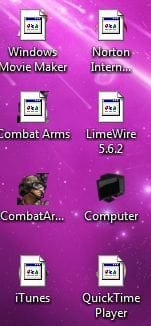

I made the mistake of not unblocking the Blank.ico file first. After that I tried to solve it using the Vista Shortcut Overlay Remover 2.0 -on my Windows 7 64 bits laptop- and now have icons on my desktop that are mostly covered with file like overlays. What a mess I made, it looks ugly!
I am not pc savvy at all. But is there a way for me clean up this mess? I might need "click ...> ...>" instructions, but any help would be greatly appreciated.

No problem mate. Move the Blank.ico file back to the desktop, unblock it, then move it back into the C:\Windows folder. Restart, and see if the overlay icon is gone now.
If not, then do step 3 in OPTION ONE to undo it, then do OPTION TWO with the program.

Hello there Brink, i wanted to remove those anoying arrows for a long time, and now that i have my new computer i gave it a try with your method.
I followed the steps to the letter so i would not encounter the problems other people had.
i logged off and on a few times and it did not work, then i restarted and nothing, now i have this... i tried to restore and nothing, then i download again and followed the steps but i still have the same problem , Plz help

Hello Autlense, and welcome to Seven Forums.
Double check the items in my post above yours to see if that may help.
WOOOW, you are amazing Brink i finally got the icon layout thing off, But i dont know if i should try to remove the shortcut thing again, because it was me who tried it and then my bro, twice each time and it didnt work.... is it my computer?

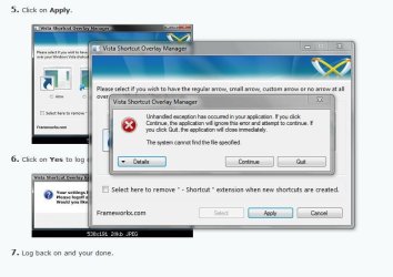

Sounds like you may have clicked on the wrong download link. Check to be sure that you clicked on one of these boxed in red below instead at the link in your post above.
this is what happen... i clicked on the no arrow option

Autlense,
Uninstall the program, and download the new version I added to the tutorial for your 64-bit Windows 7. It should work for you afterwards. The other one doesn't work with 64-bit despite what it said. :)
still no luck, i get the same warning box as the pic above
