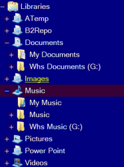

Libraries are the best thing since sliced bread. Nothing could be simpler. What do you do with your 'simple' approach if your user files are spread over 5 disks/partitions. Example my images library:
