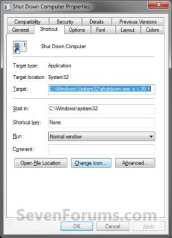

5. Right click on the new Shut Down Computer shortcut on the Desktop and click on Properties.

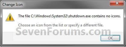

6. Click on the Shortcut tab, then click on the Change Icon button. (See screenshot below)
7. Click on OK. (See screenshot below)

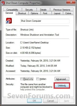

C) Right click on the Shut_Down.ico file, and click on Properties, General tab, and on the Unblock button. (see screenshot below)
NOTE: If you do not have a Unblock button under the General tab, then the shortcut is already unblocked and you can continue on.

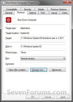

10. Select the icon and click on OK. (See screenshot above)
11. Click on OK. (See screenshot below)
