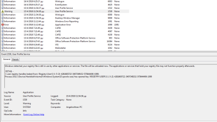

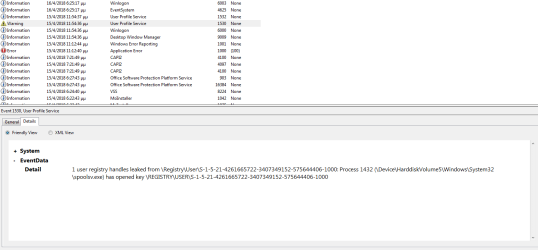

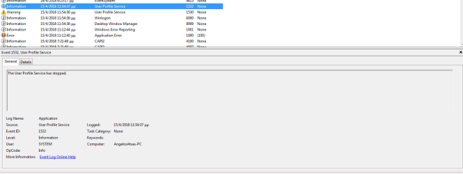

The last time I faced the problem I searched the event logs to check if anything appeared. I attach some photos of the event log, if anyone could interpret them.

Your problem is the second drive did you clone it? When windows get a disk it writes a signature hidden to the disk so it know what and were it is if you clone/copy a drive and have 2 with the same signature it thinks they are the same drive which why the errors is saying leakage from other drive

I also believe that something is wrong with the 2 disks setup. No, I did not clone the old HDD to the SSD. I made a clean setup to the SSD having had unplugged the HDD during the setup process.
I saw the warning, but I didn’t understand it. A second after, as I posted, the warning seems to be resolved (The User Profile Service has stopped).

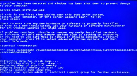

Hello everyone!
New facts about my problem. The last time I faced the problem I decided to leave the PC without force shut down to see what would happen.
After some time (I don’t know how much because l left from home), I had blue screen with the bellow information. Could anyone recognize what the problem might be?
I want to mention that after pc started I checked the event log and there wasn't any problem marked with the yellow or orange sign.
Problem signature:
Problem Event Name: BlueScreen
OS Version: 6.1.7601.2.1.0.768.3
Locale ID: 1032
Additional information about the problem:
BCCode: 9f
BCP1: 0000000000000003
BCP2: FFFFFA8003F23A10
BCP3: FFFFF80004012428
BCP4: FFFFFA8006038010
OS Version: 6_1_7601
Service Pack: 1_0
Product: 768_1
Files that help describe the problem:
C:\Windows\Minidump\042218-19500-01.dmp
C:\Users\atsas\AppData\Local\Temp\WER-21964-0.sysdata.xml
Read our privacy statement online:
http://go.microsoft.com/fwlink/?linkid=104288&clcid=0x0409
If the online privacy statement is not available, please read our privacy statement offline:
C:\Windows\system32\en-US\erofflps.txt

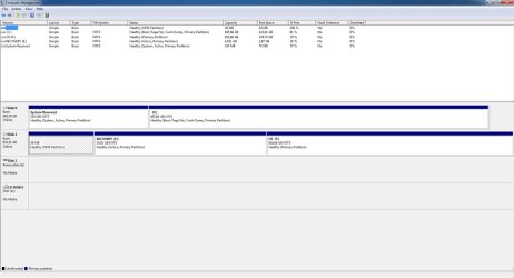

The first thing I'd do is shutdown your PC, switch off the PSU, disconnect the power lead to your HDD. Then switch on PSU, power on and boot up PC and see if BSOD recurs.

ok, this is the disk management screen.
