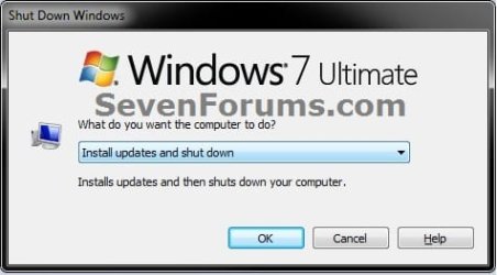

This will show you how to manage whether the Install Updates and Shut Down option is allowed to be the default choice in the ALT+F4 Shut Down Windows dialog and Start Menu "Shut Down" power button with alert shield icon for users in Windows 7 when important or critical Windows Updates are available for installation.

If you enable this policy setting, the user's last shut down choice (Hibernate, Restart, etc.) setting is the default option in the "Shut Down Windows" dialog box, regardless of whether the 'Install Updates and Shut Down' option is available in the 'What do you want the computer to do?' list. The alert shield on the Shut Down Start Menu power button will no longer display on it, even if important or critical Windows Updates are available for installation.
If you disable or do not configure this policy setting, the 'Install Updates and Shut Down' option will be the default option in the "Shut Down Windows" dialog box and Start Menu power button (alert shield on Shut Down button) when important or critical Windows Updates are available for installation.

EXAMPLE: As Default Option Start Menu Power Button and "Shut Down Windows" Dialog

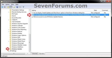

2. In the left pane, click on to expand User Configuration, Administrative Templates, Windows Components, and Windows Update. (see screenshot below) GPEDIT-A.jpg
3. In the right pane, right click on Do not adjust default option to 'Install Updates and Shut Down' in Shut Down Windows dialog box and click on Edit. (see screenshot above)
