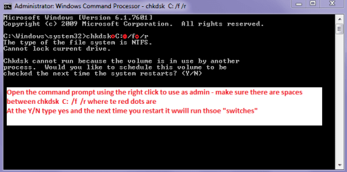

Ok mate just run the chkdsk as admin (right clcik) and see my pic as to put what where and how.
The rest you know :)
Oh in the pic I should have said type Y then hit enter and then type Exit in the command prompt
Sorry to open command prompt > Start > type cmd a blue box will open > right click Run as admin the little black box will appear typein it what I have and follow the instructions

I started the test earlier today, but it only just finished. I used a defragmantation tool to defrag the disk first. Then did the CHKDSK thing.
It found nothing. (I took a photo, but then I realised that I'm Dutch and you probably can't read Dutch haha).
After a restart I pressed the power button, and going into hibernate still took 3.5 minutes. So way to long.

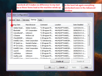

Look my two cents worth again and it might nit do anything but in msconfig screen I uncheck everything in the Start tab and in the Boot tab even the Advanced options.
If you are worried about the mouse try using a cheap wired mouse to try.
I'll give that a try.
Mouse will work when its software is disabled but it will lose some functionality. Good enough for testing purposes.
I got myself a cheap 2 bucks wired mouse just to be sure ;)
