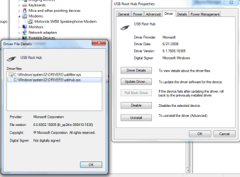

hey larry it seems that disabling some USB Root HUB devices (at least for me...;)) so far has worked for me....
i disabled some that seem to not be used even though i have every usb slot filled...:sarc:
and my guess was correct that my problem was usb based (i found out that there 7 root hubs and i only have 3 usb slots +2 for blue-tooth and Fingerprint) i disabled two and so far so good...
uptime has been for 3 hours (pluging devices and unplugging every 5-10 minutes [before such heavy unplugging would the render the system unoperable in a few minutes]...;))
it seems my sleep issue has vanished too although i need to do more testing...:)

another thing i did (although this was just a test was to see if you could overwrite some of the driver files in 7 with preferably vista sp2 ones [i only tried sp2 since i download that one from technet])
what i have done (since i downlaoded the waik recently)
was to mounnt the vista sp2 install.wim and use the drivers from there
make a backup of both your %windir%\system32\driver and %windir%\system32\driverstore\filerepository and then painfully find the driver files used, copy, restart (you will have to disable driver signing if you are x64 though) sleep and see if changes anything
(both also have to be either x86 or x64...)
from what i have seen (if you already tried disabling drivers (and as such hardware)) then it is likely these windows 7 microsoft drivers might be the cause (even more so if it works in xp or vista..)
this very tricky and so what i have done beforehand was to make a system restore image and then do the changes there...:)
(even if you are just changing usb drivers...;))
just to show the end result using a USB driver from vista sp2 in a Win7 RTM install
as you can see these are not signed because you still need the .cat or you need the certificate to be stored already in the Win7 rtm image....:)
like i said good luck...;)
