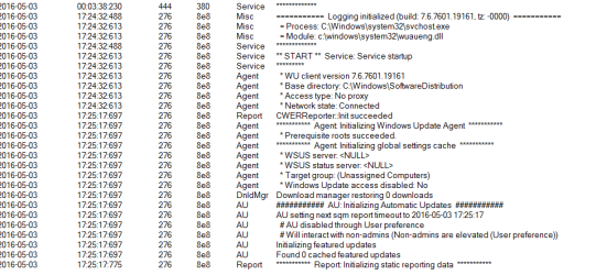

Interesting!!!
If it was trying to install it from the normal Window Update, then somethings Odd.
Part of the proceedure is to prune this type of update.
can you go
Computer >> C (or your main drive letter) >> Windows >> Windows update,
then copy/paste the final day's entries.
It should look like this -- see screenshot
Roy

Now what Roy?

I need to see it
Roy

weird.
lets try a different route.
Copy/paste it to your desktop, then open the reply, click on the paperclick and select it.
Roy

Hello Roy,
Here it is :D
