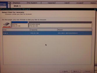

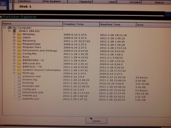

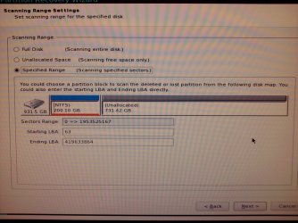

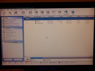

Not sure what it's supposed to be doing. Ran wizard. Got to the Choose searched partitions screen and there was my NTFS partition - proper size, etc. (see attached). I could double click it and see everything on the disk. When I click "finish" nothing else happens. It takes me back to opening screen.
So...
(and is there an option in PW to just shut down the pc after leaving app? It keeps restarting machine and I just want to shut down.)

Ok, so I guess the wizard was showing that all was well. Since it didn't really do anything I wasn't sure :-)
I had to bag it for the night and shut down right after that last email. I had to do all the work I didn't do for the last 48 hours because of this stuff.
I used PW to set the partition to inactive and shut down. I reconnected my other HDD that has Vista on it and booted right up to get to work.
I won't be able to revisit this until the weekend but when I do, I'll reset the partition to active with PW, then reboot into the system repair CD and run System Repair 3 times and see what happens.
