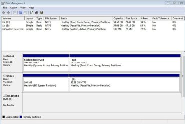

Using the Recovery Disk multiple times on different partitions did not help the situation. I would guess that your boot partition is messed up because of that. Post a screen shot of your expanded column Disk Management using your Snipping Tool and we will see what you have. http://www.sevenforums.com/tutorials/9733-screenshots-files-upload-post-seven-forums.html

DM screen shot

The System Reserved on Disk 0 looks OK to me. I assume you also have your OS on C: drive. == The first thing I would do is unplug Disk 1, and try to boot. See if that works. If it does, you will know the problem is with Disk 1. I suspect the 100 MB partition on Disk 1 is fouling up the works.

Disk1 shows an EFI System partition which means the OS was installed using EFI BIOS to a GPT formatted disk.
Click on Disk 1 in Disk Mgmt to see if it's available to be converted to MBR disk as shown in this tutorial: Convert GPT Disk to MBR Disk - Windows 7 Forums
If that is the case then you have an MBR disk for DISK0 and a GPT disk installed using EFI on Disk1 which are not compatible. I would move the data off of DISK1, wipe it with Diskpart Clean Command then format it MBR disk and partition it as desired.
I am confused by a couple of things. Your Disk 0 is your boot disk with a 100MB system reserved,active and the 2nd partition "Boot" is your OS. But my confusion is that:
1) you have your pagefile which is a system file on Disk 1.
2) Disk 1 which is GPT/EFI seems unnecessary for such a tiny HDD.
I would put your pagefile back on the Disk 0 2nd partition and run Disk 1 as a standard MBR.

Okay okay. To clean up the misconception here some... Neither of these two HDDs (disk 0 or disk 1) were ever used/booted together continually. They're actually SSDs, but anyway they each were used separately, in the same box. They were only connected simultaneously for 2 reasons:
1. When Disk 1 was no longer bootable, Disk 0 was booted with Disk 1 connected (hot-plugged after Disk 0 loaded the OS), so that the files on it (Disk 1) could be accessed via the booted Disk 0.
2. To show both of the drives parameters in the DM screen shot as requested in this thread/post.
Both used to work fine independently, and why wouldn't they - they were connected separately, hence my previous comment about they had no idea the other existed - i.e., no conflict between the two could arise since they never were together (so to speak).
All I'm interested in doing now is having a look at the desktop from within Win 7 (booting Disk 1 without Disk 0) to see what files are there, or see if a restore is available to access/retrieve them.
This has nothing to do with compatibility - I don't and won't ever use them together. The one (Disk 0) was only implemented to access the other (Disk 1), via explorer.

Now you have explain some things. I think you should be able to retain Disk 1 (the non boot SSD) as GPT if it's only for data but move the pagefile back to the 2nd partition of disk 0.
But after the experiment I'd still make disk 1 an MBR (data) disk because of any potential software compatibility issues.

Please post back another Disk Mgmt screenshot so we can see the config after reinstall.
Is the data seen from the GPT disk in Win7 now?
