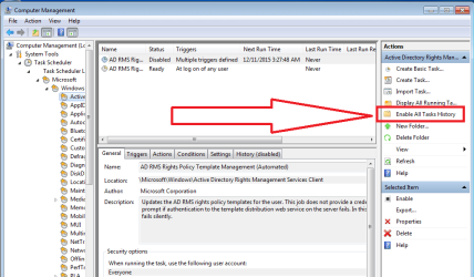

History is disabled by default.
Try selecting "Enable All Tasks History".

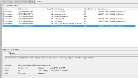

Enabled task history, put the computer to sleep yesterday (way before 9pm).
This morning I sent it a WoL command at 9:41am. It woke up and, as usual, went to sleep immediately after that. The next WoL command woke it up successfully.
Here's the history. (As you can see, nothing new there. For some reason Task Scheduler believed that there was a "time trigger condition" for launching that task at 9:41am)
