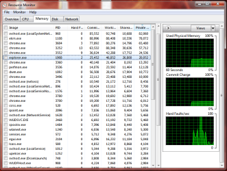

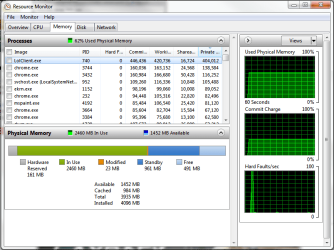

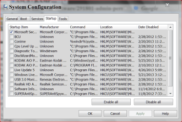

If you can use Safe Mode check msconfig and see if anything is in Startup that shouldn't be. Picture of my Start up and Resource Monitor. What I'm looking for is to see if Windows is giving you that message or something else.
Resource Monitor will show what Windows 7 is doing with your ram.

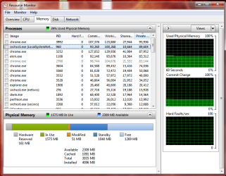

I don't need to start it in Safe Mode to be able to access those, will it matter? Here's the screen shots for both. Lolclient is the game I'm playing and it's not the problem.

Your bottom picture shows your problem.

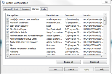

Way to many thing in startup running in the background that are not needed. Compare it to my picture.
Remember just because it is not checked in Startup doesn't mean you can't use it. It just stops it from starting at boot and running in the background when not needed.

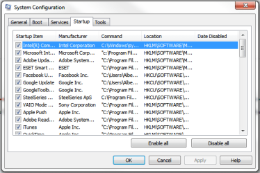

Please post another picture of msconfig Startup.

Here is the picture:

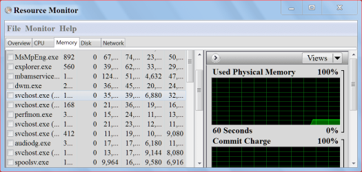

Did you reboot? If not do so. What I would like to see is Resource Monitor after the reboot with nothing but this Forum running. No games in any fashion. No torrants just this Forum.
That will let us know if your ram is being used by a hidden program somewhere.

Here it is. Chrome and the Resource Monitor are the only 2 things that I have manually opened.

And one of these.

Before you had problems of running out of ram.
Sound problems, removing and installing programs problems, couldn't open any programs including control panel or my computer. You could run anti virus scans and play games. 2+2 is not adding up to 4.
Open up comand prompt and run this
sfc /scannow and let me know what it tell you when completed.
I don't see a ram problem.
