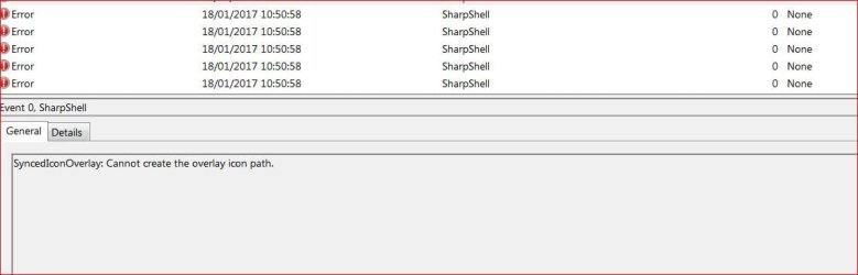

I have suddenly started getting a slew of SharpShell "0" Application errors in my Event Viewer. These aren't a major problem, but I would like to know exactly what the source application that's causing them is.
There is nothing specific that I can see in the error messages, and whilst I could probably spend time toggling between running applications and the Event Viewer, in hopes of snapshotting the cause and effect, I haven't got the time.
If anyone has information on how to identify the application easily, I'd welcome it. I've spent a lot of time searching for suggestions and relevant stuff, but there don't seem to be any.

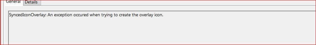

1) the only occurrence of sharpshell.dll is in Program Files\Box\Box Sync.
2) the errors crop up randomly at intervals during the day. There is no scheduled Box task set to run, and the Box Sync Update Service is set to Manual.

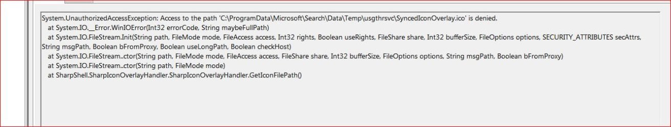

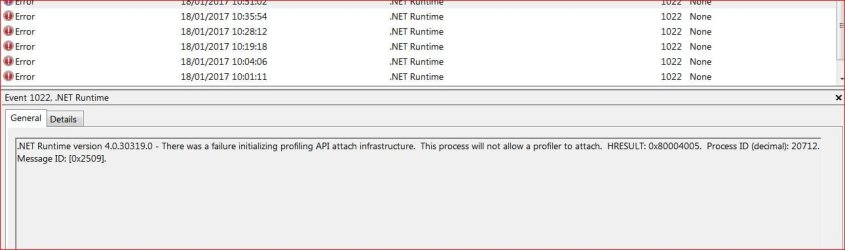

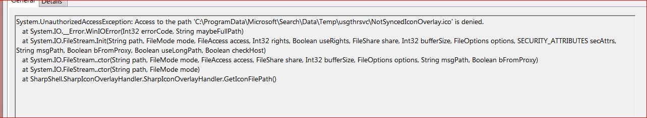

3) the Sharpshell errors occur at the same time as a .NET error (shot attached) and I notice that the last Win 7 Update Rollup contained some .NET features. These errors have only started in the last 7 days or so.
4) I've tried to tie the .NET error PID to something, but of course it's transient, and gone before I can see what it is. As you suggest, logging via Procmon is probably the only way to track it down.
5) there are shots of the Sharpshell and .NET errors attached.

Hi Foxfan,
The access denied shown is from windows search/indexing.
normal fix is to turn off reboot turn back on.
Roy

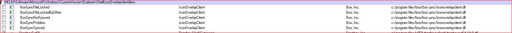

Got it!
This has happened because Box uses these dlls in the Explorer shell (and also the FreeCommander file manager which is based on Explorer). Disabling them using Autoruns gets rid of the EV errors.
If it were not for the generous space allocation on Box, I'd uninstall it right now!
