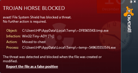

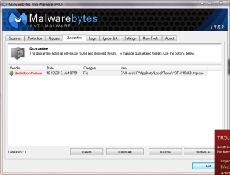

How can i remove this trojan Horse?. I am unable to remove it through avast and malwarebytes. Is there any idea to remove without harming the file system. Please help

Avast detected Win32:Tiny-ADY[trj] moved to chest. But i want to remove it completely from my laptop.

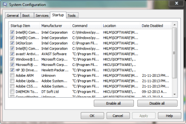

What did you uninstall? Paste a screen capture image showing all the items in your Startup tab of MSCONFIG.
Sorry for the late reply. Here is the screenshot. Well i reinstalled some software again after trying the above.

Just so you understand the 'nature' of backdoor.poison Backdoor:W32/PoisonIvy
Warning! Backdoor Trojans
These are the most dangerous, and most widespread, type of Trojan.
Backdoor Trojans provide the author or ‘master’ of the Trojan with remote ‘administration’ of victim machines. Unlike legitimate remote administration utilities, they install, launch and run invisibly, without the consent or knowledge of the user. Once installed, backdoor Trojans can be instructed to send, receive, execute and delete files, harvest confidential data from the computer, log activity on the computer and more.
If your computer was used for online banking or has credit card information on it, all passwords should be changed immediately to include those used for email, eBay and forums.
You should consider them to be compromised.
They should be changed by using a different computer and not the infected one, if not an attacker may get the new passwords and transaction information.
Banking and credit card institutions should be notified of the possible security breech.
More info can be found below:
How Do I Handle Possible Identify Theft, Internet Fraud and CC Fraud?
How to report ID theft, fraud, drive-by installs, hijacking and malware? Security | DSLReports, ISP Information
