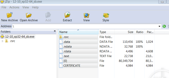

Thanks but I am now totally lost. Have installed 7-Zip but this is what I get when extracting the EXE file I downloaded from your link.
How on earth can I slipstream these into the install file. They don't even look like files! I use nLite .

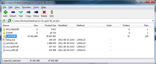

That's jzip. This is what it looks like in 7zip,
and the location of the SATA driver is,
12-10_xp32-64_sb\$_OUTDIR\Packages\Drivers\SBDrv\SB7xx\AHCI_svr\XP
