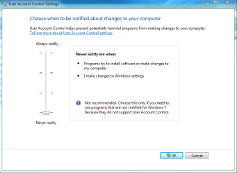

Try turning off UAC for now. What model router are you trying to connect with?
