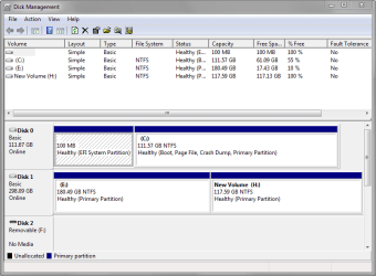

If you want to post back a Disk Mgmt screenshot (I should have asked for earlier) we can look it over for you for anything else.
Sure:
I'm not anticipating any problems at this stage!

Looks correct although there might oughta be another System partition for EFI install.
Have you determined yet if there is any advantage to having an EFI install, as they still seem more trouble then they're worth.
I just did a default install and this is what came out. I didn't actually choose one type over another!
Thanks,
Ariel
