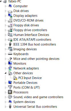

I have tried everything I know how to find out what this device is and can't get rid of the yellow triangle. The only PCI device I have is my Audigy 2ZS gamer sound card which is installed under sound devices. It's not causing any problems I'm aware of but then I still can't get my SLI to work and am looking for any conflict or possible reason for this. Any suggestions would be greatly appreciated Thanks. Fabe device mngr.PNG

The answer is coded, but right in front of you. Look at this data on your machine for the offending device.

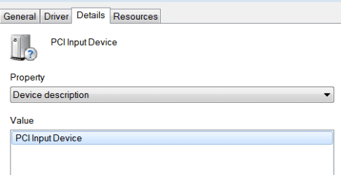

Function 1 indicates that it is part of a multi-function card. How many multi-function cards do you have? I suspect it is the joystick port on your sound card, but this is not my area of expertise.
What I do know is - the device has been specifically identified and we just have to decode it.
Capci 3.PNG this is all it says.

where it says device description, pull that bar down under it is other info

The only PCI card I have is my sound card and your probably right as i suspected it might be that, only my sound card doesn't have a game port. I just don't like having any unresolved issues in device mngr.

device>properties>details> use the pull down untill you see hardware iD's

Driver detective says no driver has been found for this device. So it can stay yellow. I really appreciate everyone's input. Fabe however it does say game port. but I don't have a game port on my sound card.
