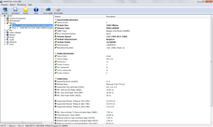

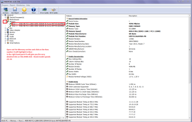

Now what I would like to see is that you use this ditty of mine and send a pic / snip of the RAM like mine I have attached.
Using HW Info
You can test the volts on the PSU with HW Info HWiNFO, HWiNFO32/64 - Download < download the right bit version and close the right hand window select Sensors and scroll down to the power section where you will see what the volts are doing see my pic.
The original right hand window shows the machine running and is handy for that but for looking at the components in some detail close it and use the main left hand side panel
FOR OTHER COMPONENTS
Open each small square with + in it on the section the components are in and then click on the individual component/s (it will highlight in blue) - in the right hand side will appear all sorts of details including brands speeds and other essential info that particular device. See pic for example.
Just use the latter part.

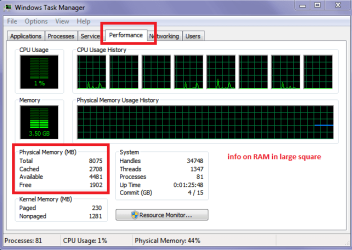

The other thing you can do is open the Task Manager > right click on the taskbar > Start task manager > in the windoe that opens click on Performance and see what is happening there.

Yes mate the doctor has a point there and why we need to see what those two suggestions I made come up with. If you like just the Task Manager one will show if the sticks are indeed installed. The other problem may be that one stick is cactus and not even going to function at all.

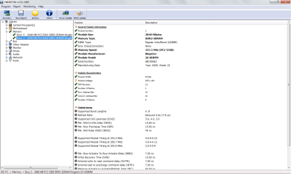

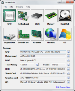

Thanks for the suggestions. I've tried reseating the RAM twice, but it hasn't made any difference. I've attached the screenshots.

Ok mate now check the labels on those RAM sticks because HW Info is telling us there is only 4GB onboard (2x2GB), if the seller sold you them - and I have to be honest I have not seen 4GB sticks of DDR2 - and ask for a refund as it clearly states what you have in those shots you have sent.
Now looking at the board it only has two RAM slots so I can only suggest you look around for sticks of a greater capacity but I am not so sure you will find any and is so they might be very expensive.
