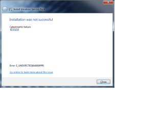

I'm simply attempting to run update on my Windows 7 machine. Update will not run, downloading and running the SP1 update fails, downloading and running the Update Readiness Tool fails, trying to launch a troubleshooter fails. I ran sfc and have attached the log along with all the error codes screenshots. I have no idea how to proceed from here other than to drop this machine off at the nearest recycling center.

Looks to me like you're having problems accessing the COMONENTS registry hive - although I would have thought that would also make a SFC scan fail.
I suspect I know what the problem is - let's see if a different tool can expose it...
I need to see a full copy of the report produced by the MGADiag tool
(download and save to desktop - http://go.microsoft.com/fwlink/?linkid=52012 )
Once saved, run the tool.
Click on the Continue button, which will produce the report.
To copy the report to your response, click on the Copy button in the tool (ignore any error messages at this point), and then paste (using either r-click/Paste, or Ctrl+V ) into your response.x
