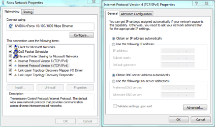

Auto Config was already turned on. It did just say "Network 2" a few hours ago before I stupidly started messing around and its now Unidentified. Here is the Ipconfig:

Ok that was a bit small hopefully this is better:

You aren't getting a default gateway from your router in either of those. And I have no idea where that ipv4 address or the DNS of 5.0.0.1 but it looks like someone was playing around with your IPv4 properties to me.
Can you look at your IPv4 properties windows and make sure it's set to obtain DHCP ip automatically and that there isn't a DNS server listed there.
