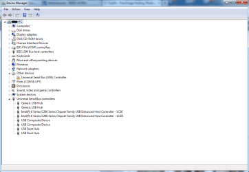

I have a look in my device manager and see this:
http://oi59.tinypic.com/91jhmp.jpg - I have attached an image to this post if you cannot click this link.
There is a warning triangle next to "other devices"
And there is no mention of USB 3.0 in the Universal Serial Bus Controllers section.

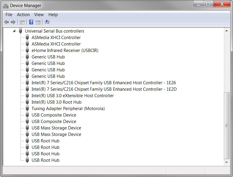

Just for example, here is the USB structure in Device Manager on my P8Z77-V Pro board. Note that there are both (a) Asmedia USB 3.0 host controller and root hub drivers for the two Asmedia USB 3.0 ports, and (b) similar Intel USB 3.0 host controller and root hub drivers for the four Intel USB 3.0 ports. These are separate from the drivers for the USB 2.0 ports.
