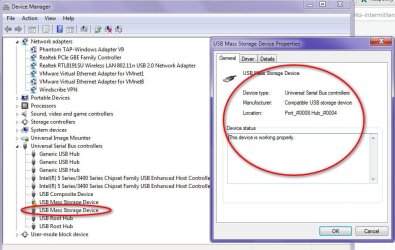

Would you go to Control Panel, Device Manager, Universal Serial Bus controllers and post a screenshot of the controllers?

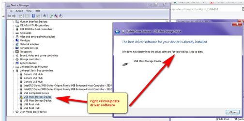

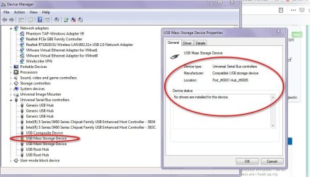

Ok thanks. Here are the screenshots. when I right click the one one with the yellow triangle and click
update driver software it says the most recent drivers are installed
How can it say no "drivers" and "the most recent drivers are installed"
When i right click and click
disable/uninstall or scan for hardware changes it hangs except in safe mode.
sometimes i get the camera connected but it vanishes from explorer after i open andbefore it is completely open
There are two USB ports on the front of the PC and regardless of whic h i plugthe disk/camera into it says "location Port_#0001.Hub_#0005" How can they both be Port_#0001.Hub_#0005?

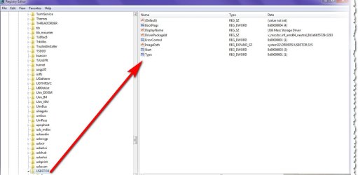

It sounds like there may be a power issue with your USB ports. However, run regedit. Go here-
HKEY_LOCAL_MACHINE\SYSTEM\CurrentControlSet\Services\USBSTOR
Provide a screen shot which shows all the values.

It sounds like there may be a power issue with your USB ports. However, run regedit. Go here- HKEY_LOCAL_MACHINE\SYSTEM\CurrentControlSet\Services\USBSTOR Provide a screen shot which shows all the values.
My drivers seems to be becoming corrupt. They are OK for a few mins after reboot then not working

Nothing wrong in the registry.
