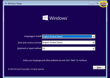

1.It's quite simple to determine that in your case. We would prepare a windows 10 usb installation media & will try to boot into it from USB 2.0 & USB 3.0 ports. The moment we boot into it, that's a software/OS problem!
As the USB ports are not working well under current installation, we would need other computer to prepare the media.
Actually, there is a good chance that USB ports are good enough & not working just because of the corrupted installation/OS. When we try to boot into installation media, actually we are trying to use the ports with different OS.
We would not install anything. We will just boot into the installation media & come out of it.
We will use latest Win 10 because win 7 sp1 does not support USB 3.0 port out of the box. With win 7 sp1 installation media, we can check only USB 2.0 port.

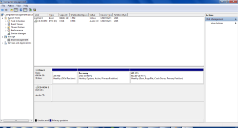

3. I need two snaps of the 'Disk Management' window of the problematic pc.
Disk Management - Post a Screen Capture Image
(a) Standard View
(b) From 'Standard View' window, navigate from 'Menu bar' to 'View > Top > Disk List' & take a snap.
( 'View' menu button is marked with yellow circle in the below image. Navigate 'View > Top > Disk List' & take the snap )

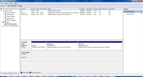

Second, the two screenshots of the Disk Management window on my laptop that you requested should appear below:
"Standard" view:
"Disk List" view:

1) Your OS partition is heavily loaded!
OS partition should not be occupied more than 60% while yours is 99%. Its a tremendous load over the resources & itself an invitation to software and/or hardware problems.
Besides, It will increase your data backup and system image sizes unexpectedly & may be a troublesome even for back up programs.
You should consider to lighten it up.

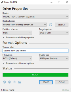

5)
This image is just for reference. Need not follow it or get confused! Follow instructions as below only :

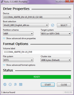

Now launch Rufus & follow strictly!
(a) When you launch Rufus for the first time, It will ask to check for updates, opt 'NO'.
(b) Select the pen drive in the Device menu
(c)click 'SELECT', browse to the win 10 iso and double click it (somethings changes & iso name will appear in the 'Boot selection' window)
(d) Choose partition scheme as MBR & Target system as BIOS ( These options may be chosen automatically but make sure you make it MBR & BIOS! )
(e) need not change any thing else
(f) press 'START' ( copying iso files, finally READY! )
(g) Take the last snap & close the rufus window, it's done.
(h) Share the snap.

Hatch & Rufus done
Sorry, I was expecting an email from the forum when the post was updated, but I guess it doesn't email me when that happens. I must only get an email for new posts.
I'm ready now. Screenshot is below:

Hi AdgeTimick,
Greets,
Sir,
Sorry for the delay. It is all well with the rufus. Now we would check USB ports one by one on your pc with the prepared USB Win 10 Installation Media.

f) After some processing, this Windows 10 screen will be presented automatically:
g) Now click the X button at the top right ( marked with Yellow Circle on the image above ) to close the window & say Yes to exit the installation media & restart the computer.
h) Now the pc should boot again in the windows 7 depending on the settings.
If it boots again in the windows 10 installation media, Don't fear! Close the window again the same way as said in (g). With the pc restarting again, keep on pressing F12 and select 'Hard disk' to boot into win 7.
If you don't get the boot menu on pressing F12 & you have delayed the pressing. Again restart & press F12 repeatedly to get the boot menu.
The USB port is working as the pen drive has been detected in the boot menu & win 10 media on pen drive has been detected!
