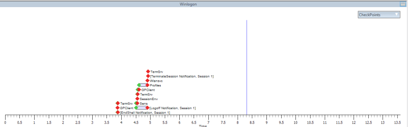

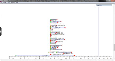

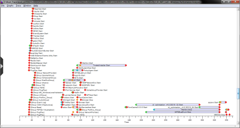

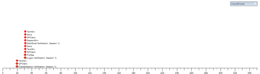

Ok, I already did it but I think it's trolling me... I did a boot trace and it powered down and booted up faster, I rebooted normally but it took ages again. I did a shutdown trace this time and again, it powered down almost immediately and booted up a bit faster.
I looked at the graphs but I'm not sure how to tell if something's out of place, I'll upload some graphs that I think might help... If that's not enough I'll try to upload the ETL file somewhere (any recommendations?).

Well from the first image I see clr_optmization taking a lot of time. From my search that involves the .net framework. Do you have the latest version of .netframework. You can see that in your programs and features.

I have these two:
-Microsoft .NET Framework 4 Client Profile v4.0.30319
-Microsoft .NET Framework 4 Extended v4.0.30319
I'm not sure if those are the latest though. I checked Windows Update and there aren't any updates available :P.

Also that wpdbusenum stop has something to do with Windows Media Player syncing to a usb flash drive over 4GB. You can disable that under msconfig->Services->Portable Device Enumerator Service.

Yes those are the latest. That's what I have as well.
